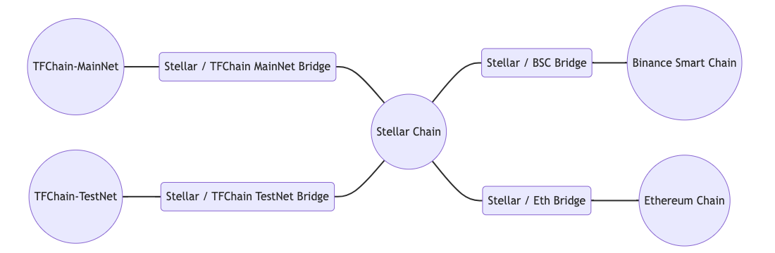

More info on the different chains with TFT and the bridges: [https://www.manual.grid.tf/threefold\_token/tft\_bridges/tft\_bridges.html](https://www.manual.grid.tf/threefold_token/tft_bridges/tft_bridges.html)
 ![tf_bridges](https://staging.forum.threefold.io/uploads/default/original/2X/1/1db812601cd9d2ad78214ca8839acbe240a0c575.png)
