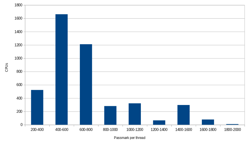

# Passmark per thread
 ![image](https://staging.forum.threefold.io/uploads/default/original/2X/d/da4757a5e1b3baca1a808ccda00595bb5adbcd5b.png)
This chart shows what you get when you take the total benchmark score for each CPU and divide it by the number of threads it has. It gives us an idea of how much performance each thread (or by extension CU reservation) can expect when the CPU is busy.
The first three bars of this chart are mostly Intel Xeon server chips that have higher thread counts. Most of the chips that hit 800 or above are the consumer Intel Core and AMD Ryzen lines, with a few higher end server models.

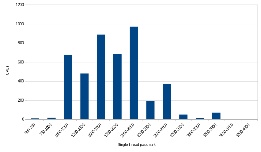

# Single thread rating
 ![image](https://staging.forum.threefold.io/uploads/default/original/2X/f/fa5a1772857127d01c08c35c70e3c8017055e492.png)
This shows the performance when only a single thread is in use. Comparing to above, we can see how multi core and multi threaded systems have to share resources when the multitask, but can execute a single task with better performance, in general. It’s also the case that certain CPUs are more optimized for having many threads versus single thread performance. Likewise, this is more and less important for different applications.

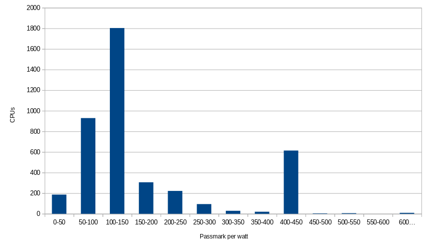

# Efficiency
 ![image](https://staging.forum.threefold.io/uploads/default/original/2X/0/0d1fc08e1c489c7d1b543f4598625f61ea9752db.png)
Here, we take the total benchmark score and divide it by the TDP rating (typical power usage in watts). This chart should definitely come with a caveat that TDP is a single figure provided by CPU manufacturers that definitely doesn’t give the full picture on a chip’s power consumption under different kinds of loads.
You’ll notice the spike out to the right, which are our Intel NUC based Titans. I’d be curious to see some comparisons of NUCs versus enterprise grade hardware performing the same job (maybe a cluster of NUCs versus one big server). Of course, there are other reasons to prefer a bigger machine with features like redundant power supplies.
