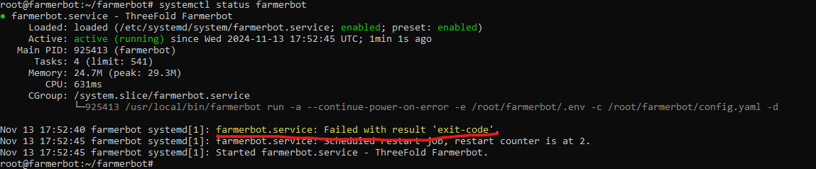

I just updated my farmerbot. Is this an error or is my farmerbot ok?
 ![image](https://staging.forum.threefold.io/uploads/default/original/2X/2/26fb267791314802faa7c4054ebf5e2ce806e713.png)
**Author:** ![tullysinc](https://staging.forum.threefold.io/user_avatar/staging.forum.threefold.io/tullysinc/32/1996_2.png) [@tullysinc](https://staging.forum.threefold.io/u/tullysinc)\
**Post date:** [November 13, 2024, 8:13pm UTC](https://staging.forum.threefold.io/t/tfgrid-3-15-release-farmerbot/4433/10 "2024-11-13T20:13:40Z")
Hello there,
That notification is not necessarily an issue as you can identify from the subsequent lines the bot restarted again. You might also want to check your logs to be sure:
_tail -n 50 farmerbot.log_ prints the last 50 lines. If there are no errors projected in the logs then it should be fine.

> Also I updated my farmerbot to 0.16.0
> How do I know it is working? Additionally nano config.yaml doesn’t work for me.
The best way to check that the bot is working is to look at the most recent entries in your log file.
If you can’t open the config file, I’d suggest to look inside your systemd unit file and check the paths:
```bash
cat /etc/systemd/system/farmerbot.service
You should see the full path to the config file and env file in the output.
