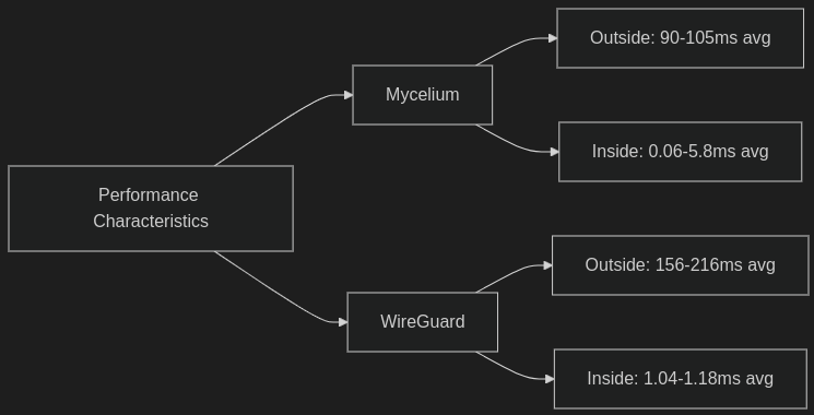

Key Observations
- Mycelium Wins Externally: 2x faster than WireGuard, zero packet loss.
- WireGuard Better Internally: Slightly faster, but both are excellent.
- Public IPs ≠ Optimization: Performed no better than WireGuard externally.
