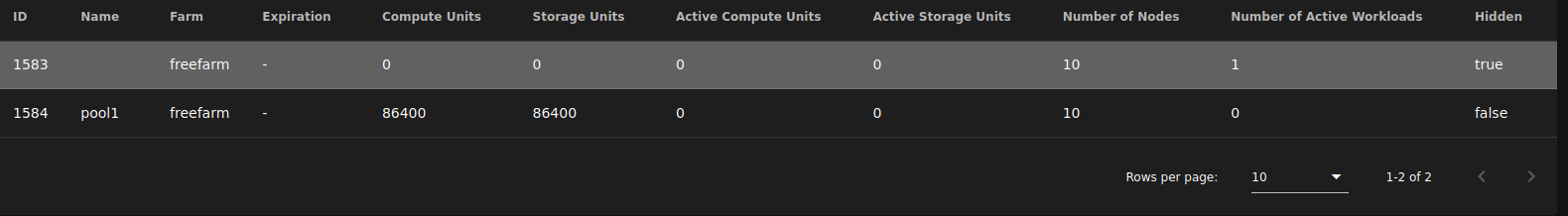

So first, I created a pool capacity. Here first strange thing, the chatflow created not 1, but 2 capacity pools in the process, both with very strange proprieties. Here is what I have:
So basically, the first pool has nothing, and the second one has a huge 86400 CU and SU when I asked only 1 of each, and no expiration date. I notice that I can’t delete a capacity pool, only hide it.

Ok so seems you’ve indeed hit a weird bug with these 2 pools created. I’ll open a issue for it. Thanks for reporting.
The reason you don’t have an option to delete a pool is because normally you would never want to do that because that would mean you would loose any capacity your bought there. So instead we just allow to hide IT from the UI so you can keeps things clear.
